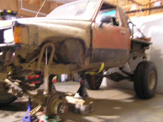

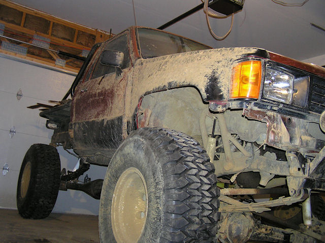

Ok its time to bring the site back to life so here we go lookin for input and opinions on the build.  heres what the truck is working with right now.  its a 87 toyota with a 85 front end sas conversion.  new motor that is running right finally.  gotta 5 to 1 t case with a high clearance skid plate and mount.  rockin the lock right out back with 5.29s.  open up fornt with 5.29s.  gotta the allpro flat bed conversion with the fuel celll from blue torch.  rockin 35 12.50s on mickey thompson wheels.  front ends brakes have been upgraded  along with the hysteer kit.
So its winter here in indiana and that means its time to break out the heater and start working in the garage so heres the plan for this year.  the body is gonna come off once agian and gonna put custome leaft springs in the front to acheive about 4" of lift.  and when i mean custom i am talking about the rears springs with some other springs addded in what ever gives me four inchesw there is a couople of different set ups lol.  but in doing this i am also gonna move the front axle up 1 to 2 inches.  at the same time the back suspension will be seeing a 5" lift from our friends at allpro who might have dicked me on the shipping but still love them lol.  also i am using longer springs for more flexation and that is a word for those of you trying to figure that out you can look in the off road dictionary lol.
the frontend is also gonna see a complete rebuild kit tired of the leaking birfs all over my garage but toyota does make a killer axle lol.  also gonna throw a line lock on the brake system in an attempt to do away with the shiznitty e brake.  this is also gonna coem in handy when i put the next and most kill point on.  o yea were gonna throw a rear driveshaft disconnect on yep front burns here we come.  so what you guys think about the plan. lol

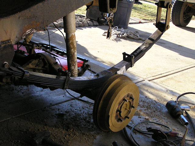

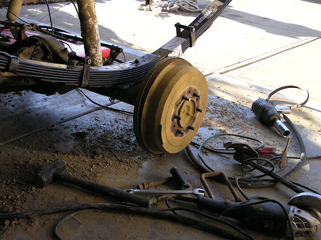

12/28/2008 5:30 PM
So i threw on the rear springs today. i thought that they were gonna be way to stiff but once i got them on and pushed down on them i couldnt believe how soft they were. i really perfer these over the usal 63" chevy springs these springs are i think 56" compared to like the stock 48" coorect me if i am wrong didnt take measurements. 56" puts the new front hanger right at the up cure for the rear part of the frame. the 63 just put the front hanger way to forward might be good for on the cheap but i wheel hard and like to drag my belly over shiznit so will see how this works.

01/02/2009 12:29 PM
Danny - here's how you post photos... http://www.4x4review.com/Forums/tabid/97/forumid/46/postid/18519/view/topic/Default.aspx
I went ahead and posted them though.
It's looking REALLY good my man! Can't wait to see some more photos, and definately some action shots!

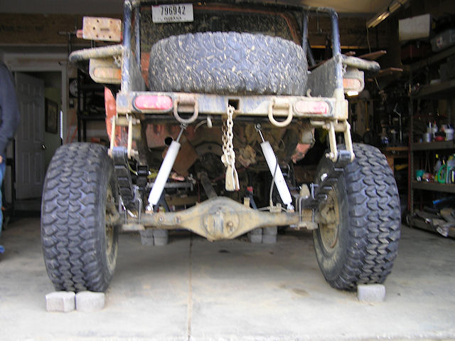

01/02/2009 4:26 PM
so what you think about the shock setup stole it off the old cruiser set up you had. its all in house fab work anymore. i just thionk that i might have not put enough angle on the shocks when i made the mount. heres the deminsion 10inches in on the frame mount. then i went two inches in on the axle. the shock is 30 inches long at extension. and the axle is 22 inches away from the the frame at full droop now there is gonna be down wards pressure wheh i start to flex it out so i hope it uses all of the shock lol.

01/04/2009 12:06 PM
Looking good, Danny!!!
As far as the shock angles go... You can't really "look" at the angles and see if they are right or wrong, it's really all about the math and taking measurements. Here's an article we did on this...
http://www.4x4review.com/Features/Tech/BeAGeniusShockAbsorbers/tabid/307/Default.aspx
In particular, read this paragraph, and the paragraph above it that shows the effective dampening rates of shocks when mounted at an angle (it changes greatly)...
