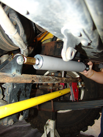

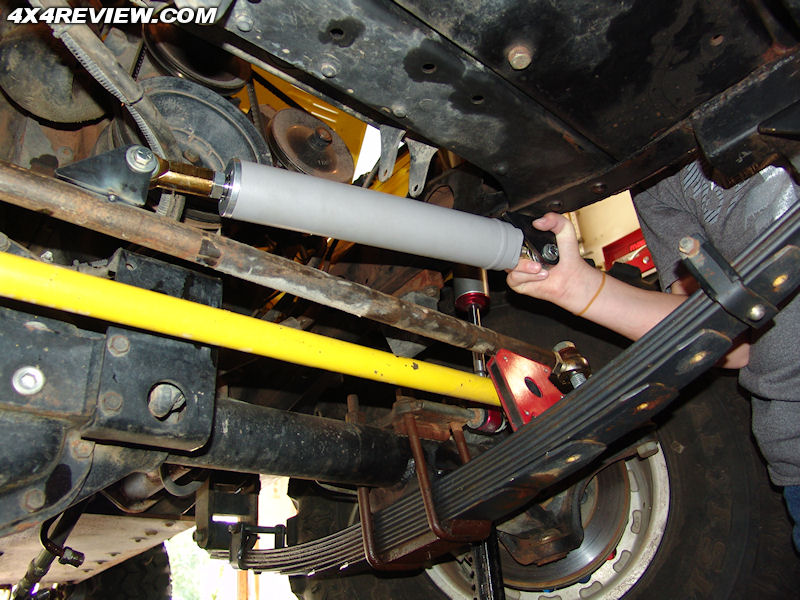

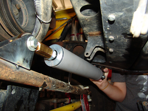

I ended up having to put brackets on the bottom of my passenger-side frame rail (as low as possible, to try and get it horizontal), and then attach the ram end to my drag link. I have a D44 up front with a Detroit e-Locker, which means I didn't have room to mount it normally. Something like this might work for you, but the only downside is if your front axle articulates a LOT, then the geometry changes slightly and steering through the ram fades a tiny bit (probably not noticable).
If interested, I can send a few pics of my setup.
01/23/2009 7:34 PM
Here are a few pictures. As mentioned - this isn't the optimal setup, as the geometry will change slightly when the axle fully compresses or fully droops on that side.
Also, be SURE that you off-set the ram at an anlge (forward / backward), so that when the suspension compresses, the drag link doesn't hit the ram.
