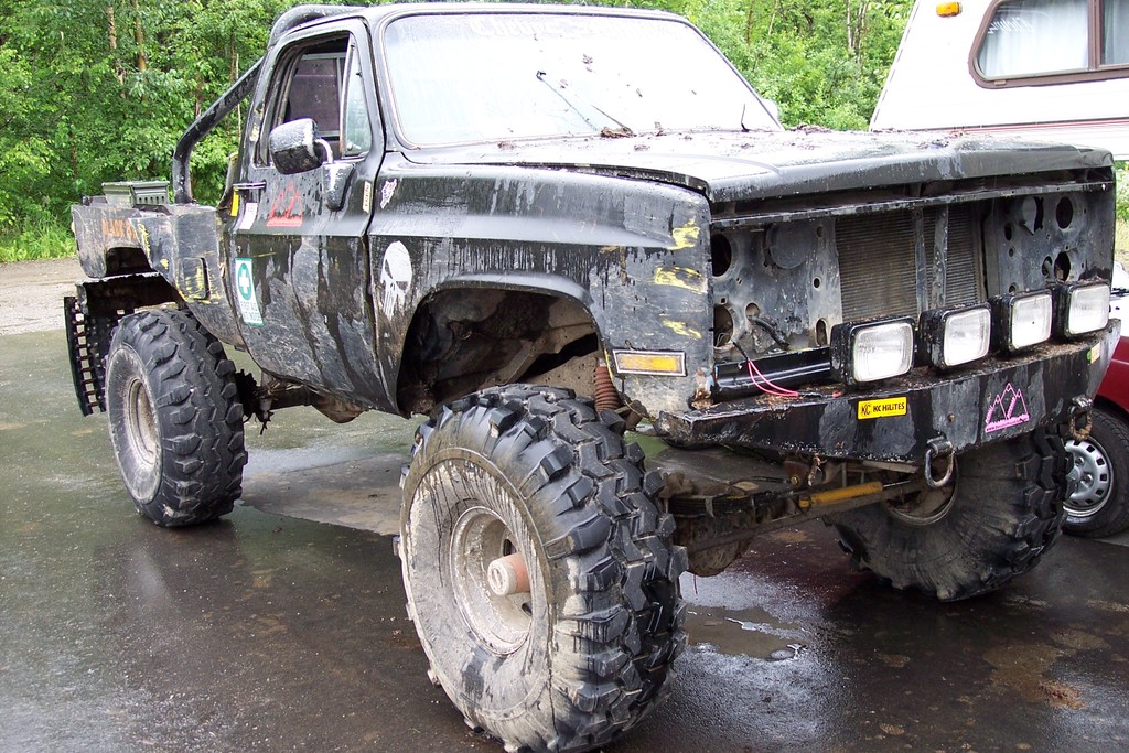

[img]http://i195.photobucket.com/albums/z95/Chevyman0784/seep01.jpg[/img] Here is something that would have helped that guy out!!!!!!!!!!!!

That's awesome... think you can get 42" IRoks on that? :)

Haha, only with minor fender trimming and some Bush Whackers....lol. I wonder if that would effect its floating ability?? lol.
