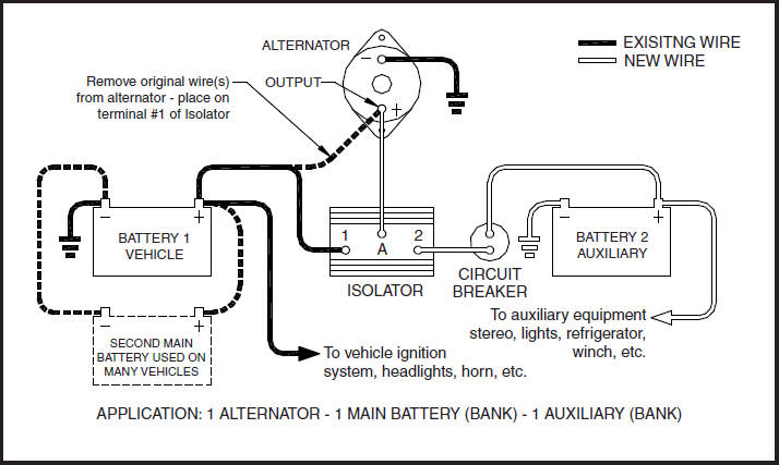

Hi Lund - unfortunately, you cannot just hook your 2nd battery up to your 1st battery, unless you want a nice acid shower underneath your hood. <img src=
In all seriousness, you need what it called a "battery isolater". Be sure to get a diode style isolator (most are), otherwise you'll need about 50 pounds of wiring and it's a pain in the butt. A normal diode-style isolator only has three posts on it, and they're pretty easy to wire up. You can get a decent one for under $40 at your local auto parts store.
They look like this: http://www.northerntool.com/webapp/wcs/stores/servlet/product_6970_200343388_200343388
Wiring them is pretty straightforward... Here's a sample diagram:

Ok thanks, so basically what I need to do is get the isolator and hook it to the altenator with the two batteries hooked to the isolator. I do have a couple questions though. What kind of advantages will I see with this setup? And what size altenator would I need? I have a stock altenator right now, so I assume its probly putting out about 65 amps.
webby4x4User is Online
05/22/2009 4:19 PM
Hi Lund - yup, they're pretty easy to wire into place!
Advantages:
1) it isolates your cranking/starting battery from your accessories battery. This way, if you drain your 2nd battery dead, because you left off-road lights on, a stereo on, etc., you won't be stranded.
2) You get extended life out of your batteries
Alternator:
Your stock alternator should be fine unless you are running excessive draws from your battery(ies). If you are running excessive draw, then you should upgrade to a 90 amp alternator.
Your stock alternator is probably either 60 amps or 65 amps.

Yeah that helps a lot. Thats what I think I am going to do. I think I will have to upgrade my alternator though. I have 6 off road lights and am planning on installing a winch. One more question though, where would you suggest I mount the isolator?
06/15/2009 8:51 PM
Doesn't really matter where you mount it - most isolators (at least the good ones) are fully potted (i.e. water resistant). Personally, I would mount it high on the firewall or on top of the inner fenderwell. However, be sure to keep it away from the exhaust manifolds / headers though. Heat will kill it pretty quickly.
If you do a LOT of mudding / water crossing, you might consider routing it through your firewall and mounting it inside the cab of your truck.
P.S. do NOT skimp on the battery cables. Running too thin of a battery cable is a bad idea.
Hope that helps.

Indy - they still run an isolator in addition to the swtich though, right? Otherwise, how does the alternator charge the second battery?

It does if it's run through an isolator... which is why I recommended that in the first place. :)
