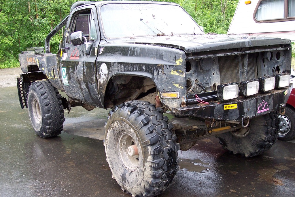

ChevyMan0784User is Offline
Posts:699
10/10/2008 12:13 AM
[img]http://i195.photobucket.com/albums/z95/Chevyman0784/seep01.jpg[/img] Here is something that would have helped that guy out!!!!!!!!!!!!
gimmie fuel gimmie fire gimmie that which I desire-James Hetfield *Never give an Irish man good cause for revenge. *Guns dont kill people, but they sure help!! *98% OF AMERICANS SAY 'OH S**t' BEFORE GOING IN THE DITCH ON A ICEY ROAD. THE OTHER 2% ARE FROM ALASKA, AND THEY SAY, 'HOLD MY BEER AND WATCH THIS
webby4x4User is Online
10/10/2008 10:30 AM
That's awesome... think you can get 42" IRoks on that? :)
